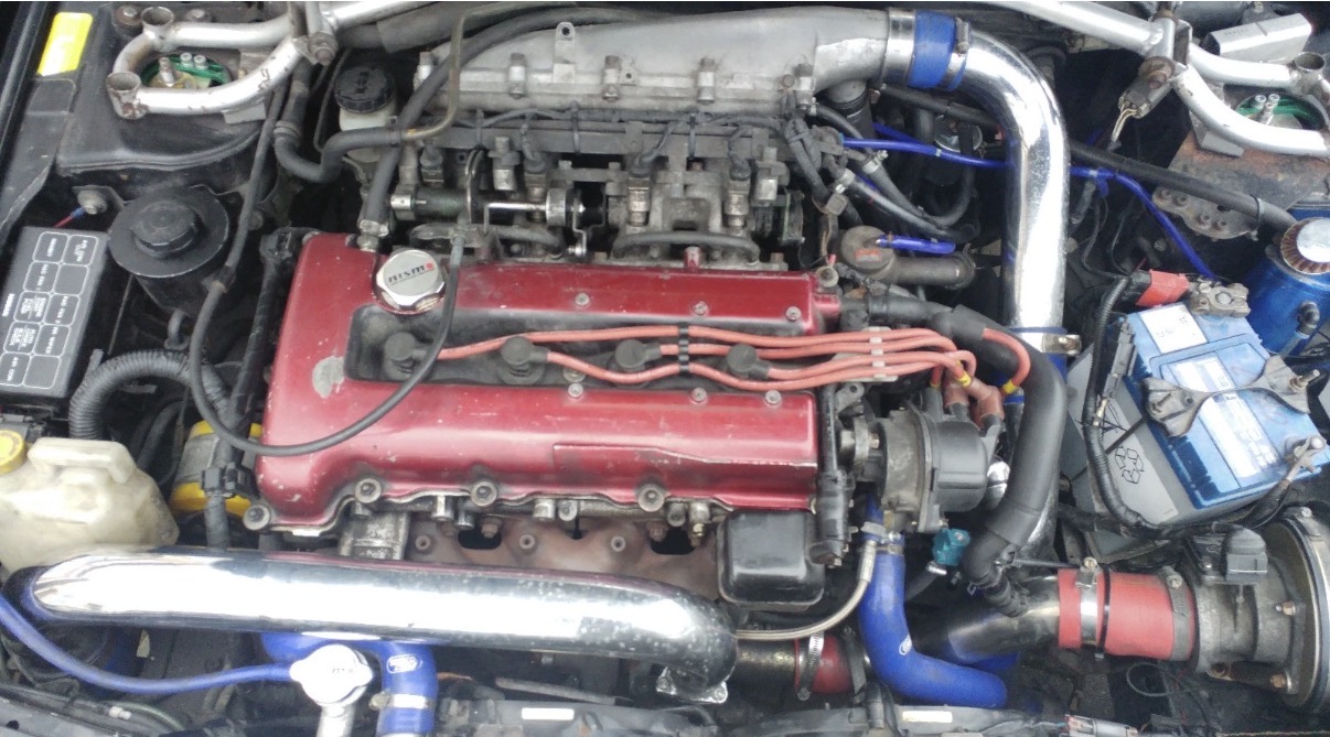

The car has had various new parts over the years (brake callipers, oil and water pumps, water hoses, OEM head bolts, DET sensor, master cylinder, wheel bearings, track rod ends, timing belt, etc, etc) so seems to have been well maintained mechanically (have a stack of receipts from 2007 to now) and I personally have spent more money on the car than I can afford, including replacing the sills as she was suffering from terrible corrosion and rot along both sides, outer and inner (see pictures below). Car is nicely modded for good performance whilst maintaining a good level of reliability (see details below) and drives almost perfectly. The gearbox is tight and smooth and the engine pulls strongly on boost (1.2 bar), producing 332 bhp and 318 lbs ft. Bob at GTI-R Us had to turn the timing down 1 or 2 degrees, otherwise the torque produced would have been too high for the stage 1 clutch and transmission reliability at well over 330 lbs ft. Also, the injectors, air flow meter, ECU, etc. would have been maxed out at the power levels achieved.

Engine
Polished crank
86mm CP forged pistons
Cosworth 1.5 mm hg
ARP con-rod bolts
ACL race bearings
New head bolts
Mine’s ecu
Turbo Technics stage 1 Garrett hybrid turbo (360 thrust bearings)
Braided turbo lines
Uprated turbo elbow (from Bogdan)
Large fmic
Blitz SUS air filter
Hi-teq induction hard pipe
Polished and ported exhaust manifold with blueprinted head exhaust ports at GTIRUS
Mongoose 2.5 down pipe and decat exhaust with 4-inch tail pipe
Walbro 255 fuel pump
Sonic cleaned injectors
New water pump
New Nissan oil pump
Samco coolant hoses front and rear
Japspeed aluminium race radiator
Nismo Thermostat
Gizmo ms-ibc boost controller 1.25 bar boost
Greddy turbo timer
Magnecore kv85 leads
NGK BR8ES spark plugs
Powerflex engine mount
Carbon canister removed
